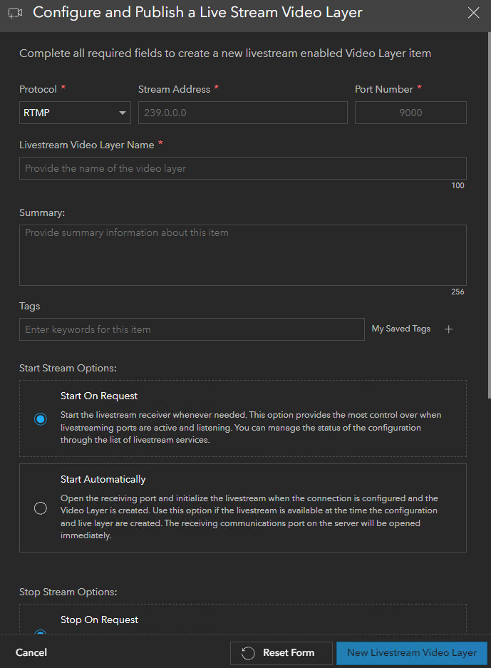

When I created the livestream video layer in ArcGIS Excalibur, my settings were as shown below:
Protocol : RTMP
Stream Address: IPv4 address of my computer (got by typing "ipconfig" in cmd)
Port Number: 1935 (port provided by Mona Server.exe)

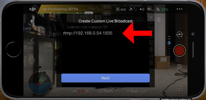

After I successfully created the layer, I used the link "rtmp://{my IPv4 address}:1935" in the drone livestream
In this way, the drone was supposed to connnect to the livestream video layer in ArcGIS Excalibur. But the error kept poped-up:

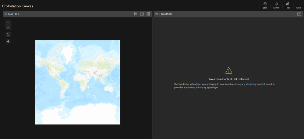

Additionally, I am facing an issue where I am unable to directly open the exploitation canvas in ArcGIS Excalibur. Instead, I have to access ArcGIS Online, search for "Content," locate the specific layer I created, and click on "Open in ArcGIS Excalibur." Although the canvas appears as shown in the provided picture, the livestream connection is still not established.
clai
Does anyone know why the livestream connection is not successful? Is there any parameter I set wrong? By the way, I can successfully connect the drone to other software like VCL player following the same process but failed with ArcGIS Excalibur.
clai
I successfully connected stream to Excalibur through UDP now. But the problem is the metadata of the video missed.
