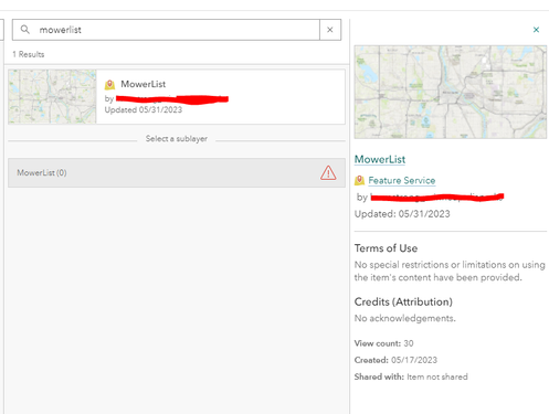

When trying to add any table to any of my real time analytics, I get this error.  Even if I try to add the exact same table that is already in my real time analytic for a second time, I get the error:

@ArmstKP thanks for the question, this is a known issue and will be fixed soon in a upcoming release.  The workaround is adding it in manually in the source json for the analytic. Please reach out directly  and we can walk you through how to do that.

Just an update to others.  This issue hasn't been addressed in the new Velocity update today.
PeterNasuti
@ArmstKP The update today is for a Velocity system component. The upcoming release (Velocity 4.2 Patch 1) is schedule for next Wednesday (8/9/23) which addresses the table source issue and other items. Sorry for any confusion introduced regarding these two different updates.
