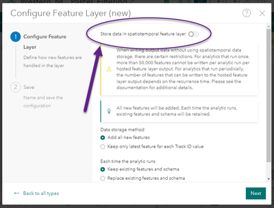

PeterNasuti
Based on the icons and the fact that there is an accompanying map image layer, you have created a "Velocity feature layer" with data stored in a spatiotemporal layer. This layer type cannot be shared to the public, thus the error message you witnessed.
ArcGIS Online hosted feature layers however can be shared to the public. The Velocity "Feature layer (new)" output can be configured to create an ArcGIS Online hosted feature layer. See the following screenshot for reference. By unclicking the toggle "store data in a spatiotemporal feature layer", when unchecked the corresponding feature layer created will exist in the ArcGIS Online hosted feature layer. You can also use the "Feature layer (existing)" output to write to an existing ArcGIS Online hosted feature layer.

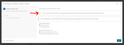

@PeterNasuti Thank you.  I have tried this as well, but our AVL snowplow feed is usually around 10 e/s and thus our average is above 2 e/s in our feed.  So, I am not able to save and start the feed to create the Feature layer (new) output.  Does this basically mean that I just won't be able to share last vehicle locations to the public?
PeterNasuti
Thanks for your reply - it is correct that the Feature layer (new or existing) output when writing to an ArcGIS Online hosted feature layer is limited to an average of 2 events/second (120 records per minute, per output). This is a limit imposed from the ArcGIS Online team that ArcGIS Velocity follows. ArcGIS Online organizations with a premium feature data store are able to sustain/allow higher data write speeds. This will be available with the following release of ArcGIS Velocity in early 2023.
For some public facing applications, organizations will utilize the Control Event Volume tool to reduce the number of updates/records sent to an output based on feature Track ID. This could be leveraged in your circumstance to keep your update Velocity around/under 2 e/s to be able to write to an ArcGIS Online hosted feature layer if you need to share this layer with the public. The downside to this workflow would be that vehicle location updates to the public could be slightly delayed (likely under a minute, it depends on your number of vehicles and update frequency).
https://doc.arcgis.com/en/iot/analyze/control-event-volume.htm
We have also implemented a validation enhancement to change the 2 event per second validation error to be a validation warning. There are perfectly valid cases where a feed has a higher rate than 2 e/s but the analytic flow reduces the number of features to under 2 events per second at the output. This will be implemented with our 3.3 release in early November, however the current workaround is to start the feed, and then start the real-time analytic before the feed has started (or start the real-time analytic first).
