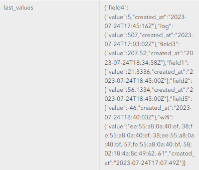

I have data coming in from a feed that is structured as below.  The field "last_values" won't flatten.  When I choose "Flatten Array" it does not flatten the field.  Is the reason it doesn't flatten is because there is no "[" at the beginning of the field and no "]" at the end.  If so, how would I get this to function?
{"field4":{"value":5,"created_at":"2023-07-24T19:45:15Z"},"log":{"value":507,"created_at":"2023-07-24T17:03:02Z"},"field3":{"value":181.44,"created_at":"2023-07-24T19:49:59Z"},"field1":{"value":21.4191,"created_at":"2023-07-24T19:55:02Z"},"field2":{"value":55.996,"created_at":"2023-07-24T19:55:02Z"},"field5":{"value":-45,"created_at":"2023-07-24T19:50:06Z"},"wifi":{"value":"ee:55:a8:0a:40:ef,-38;fe:55:a8:0a:40:ef,-38;ee:55:a8:0a:40:bf,-57;fe:55:a8:0a:40:bf,-58;02:18:4a:8c:49:62,-61","created_at":"2023-07-24T17:07:49Z"}}

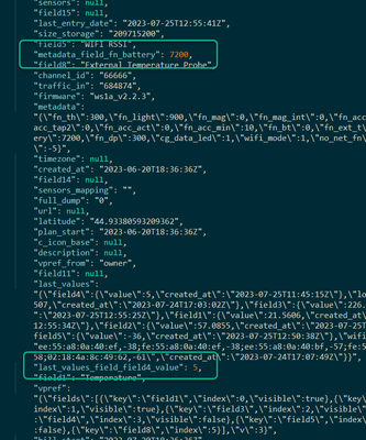

Absolutely! I put together some samples in Arcade (using the Calculate Field tool) to show what it would look like to grab values for specific fields. You would need to ensure to provide sample values for the fields for the Arcade expression builder to successfully evaluate an expression.
Example 1: Acquire "fn_battery" value from "metadata" stringified JSON block
// Sample workflow to acquire the "fn_battery" field from "metadata" escaped JSON object field
// Sample value for metadata field:
// {\"fn_th\":300,\"fn_light\":900,\"fn_mag\":0,\"fn_mag_int\":0,\"fn_acc_tap1\":0,\"fn_acc_tap2\":0,\"fn_acc_act\":0,\"fn_acc_min\":10,\"fn_bt\":0,\"fn_ext_t\":600,\"fn_battery\":7200,\"fn_dp\":300,\"cg_data_led\":1,\"wifi_mode\":1,\"no_net_fn\":0,\"time_zone\":-5}
// Step 1: Remove the backslashes from the stringified JSON
var slashReplace = Replace($feature.metadata,'\\','');
// Step 2: Convert the non-escaped "proper" JSON to a JSON dictionary, and grab the element of interest
FromJSON(slashReplace)['fn_battery'];
Example 2: Acquire "field4 > value" value from "last_values" stringified JSON block
// Sample workflow to acquire the "field4 > value" field from "last_values" escaped JSON object field
// Sample value for last_values field:
// {\"field4\":{\"value\":5,\"created_at\":\"2023-07-25T11:45:15Z\"},\"log\":{\"value\":507,\"created_at\":\"2023-07-24T17:03:02Z\"},\"field3\":{\"value\":226.4,\"created_at\":\"2023-07-25T12:55:25Z\"},\"field1\":{\"value\":21.5606,\"created_at\":\"2023-07-25T12:55:34Z\"},\"field2\":{\"value\":57.0855,\"created_at\":\"2023-07-25T12:55:34Z\"},\"field5\":{\"value\":-36,\"created_at\":\"2023-07-25T12:50:38Z\"},\"wifi\":{\"value\":\"ee:55:a8:0a:40:ef,-38;fe:55:a8:0a:40:ef,-38;ee:55:a8:0a:40:bf,-57;fe:55:a8:0a:40:bf,-58;02:18:4a:8c:49:62,-61\",\"created_at\":\"2023-07-24T17:07:49Z\"}}
var slashReplace = Replace($feature.last_values,'\\','');
FromJSON(slashReplace)['field4']['value'];
I then confirmed the success of this expression to an output. Let me know if there are any other questions!

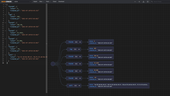

I pasted the data as a picture not as text so I can't try it for you -- But go to JSON crack and paste your JSON structure into the left panel after clearing out the sample JSON already in there.  This will let you look at what you are asking Velocity to parse at a more detailed level.
But yes, an array is defined as between two square brackets.  []
https://jsoncrack.com/editor
ArmstKP
@JeffSilberberg This is what I receive back from jsoncrack.
JeffSilberberg
Correct, you do not have an array to flatten there - -

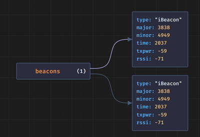

Where as this is an array of iBeacon reports --
{ "beacons": [
    "type": "iBeacon",
    "major": 3838,
    "minor": 4949,
    "time": 2037,
    "txpwr": -59,
    "rssi": -71
    "type": "iBeacon",
    "major": 3838,
    "minor": 4949,
    "time": 2037,
    "txpwr": -59,
    "rssi": -71

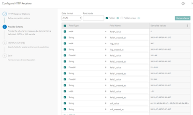

So put your JSON into the HTTP Feed Receiver - And you will get a schema that you can then reference in the Analytic -- Be sure to click Flattern, but not Flatern Arrays.
Then in the Analtic, for example, you will have $feature.Field3_value or $feature.Field3_created_at  .....
PeterNasuti
@ArmstKP For this case you would be clicking "Flatten" instead of "Flatten Arrays". Flatten arrays is only to flatten items contained in square brackets [/] as an array that actually contains data values. Flatten is to flatten {/} objects.

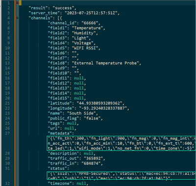

Here is my full JSON:
{"result":"success","server_time":"2023-07-25T12:57:51Z","channels":[{"channel_id":"66666","field1":"Temperature","field2":"Humidity","field3":"Light","field4":"Voltage","field5":"WIFI RSSI","field6":"","field7":"","field8":"External Temperature Probe","field9":"","field10":"","field11":null,"field12":null,"field13":null,"field14":null,"field15":null,"latitude":"44.93380593209362","longitude":"-93.29240328337887","name":"South Side","public_flag":"false","tags":null,"url":null,"metadata":"{\"fn_th\":300,\"fn_light\":900,\"fn_mag\":0,\"fn_mag_int\":0,\"fn_acc_tap1\":0,\"fn_acc_tap2\":0,\"fn_acc_act\":0,\"fn_acc_min\":10,\"fn_bt\":0,\"fn_ext_t\":600,\"fn_battery\":7200,\"fn_dp\":300,\"cg_data_led\":1,\"wifi_mode\":1,\"no_net_fn\":0,\"time_zone\":-5}","description":null,"traffic_out":"365892","traffic_in":"684874","status":"{\"ssid\":\"MPRB-Secured\",\"status\":\"mac=ec:94:cb:7f:a1:b4,usb=1,ota_status=0,ota_errcode=0,ota_sec=0\",\"usb\":\"1\",\"mac\":\"ec:94:cb:7f:a1:b4\"}","timezone":null,"created_at":"2023-06-20T18:36:36Z","updated_at":"2023-07-05T18:33:58Z","usage":"4246875","last_entry_id":"22425","last_entry_date":"2023-07-25T12:55:41Z","product_id":"ubibot-ws1a","device_id":"0f006003a36a04a35c41ab64cc9f40148382e1bb","channel_icon":null,"last_ip":"73.228.129.155","attached_at":"2023-06-20T18:36:36Z","firmware":"ws1a_v2.2.3","full_dump":"0","activated_at":"1687294250","serial":"K775***WS1A","mac_address":"ec:94:cb:7f:a1:b4","full_dump_limit":"3","cali":null,"size_out":"1073741824","size_storage":"209715200","plan_code":"ubibot_free","plan_start":"2023-06-20T18:36:36Z","plan_end":null,"bill_start":"2023-07-20T18:36:36Z","bill_end":"2023-08-19T18:36:36Z","last_values":"{\"field4\":{\"value\":5,\"created_at\":\"2023-07-25T11:45:15Z\"},\"log\":{\"value\":507,\"created_at\":\"2023-07-24T17:03:02Z\"},\"field3\":{\"value\":226.4,\"created_at\":\"2023-07-25T12:55:25Z\"},\"field1\":{\"value\":21.5606,\"created_at\":\"2023-07-25T12:55:34Z\"},\"field2\":{\"value\":57.0855,\"created_at\":\"2023-07-25T12:55:34Z\"},\"field5\":{\"value\":-36,\"created_at\":\"2023-07-25T12:50:38Z\"},\"wifi\":{\"value\":\"ee:55:a8:0a:40:ef,-38;fe:55:a8:0a:40:ef,-38;ee:55:a8:0a:40:bf,-57;fe:55:a8:0a:40:bf,-58;02:18:4a:8c:49:62,-61\",\"created_at\":\"2023-07-24T17:07:49Z\"}}","vconfig":"{\"field1\":{\"h\":\"0\",\"u\":\"1\"},\"field2\":{\"h\":\"0\",\"u\":\"3\"},\"field3\":{\"h\":\"0\",\"u\":\"4\"},\"field4\":{\"h\":\"0\",\"u\":\"5\"},\"field5\":{\"h\":\"0\",\"u\":\"6\"},\"field8\":{\"h\":\"0\",\"u\":\"14\"}}","vpref":"{\"fields\":[{\"key\":\"field1\",\"index\":0,\"visible\":true},{\"key\":\"field2\",\"index\":1,\"visible\":true},{\"key\":\"field3\",\"index\":2,\"visible\":true},{\"key\":\"field4\",\"index\":3,\"visible\":false},{\"key\":\"field5\",\"index\":4,\"visible\":false},{\"key\":\"field8\",\"index\":5}],\"v\":3}","sensors":null,"sensors_mapping":"","battery":null,"vpref_from":"owner","net":"1","c_icon_base":null,"full_serial":"K7750M8WS1A","triggering_rules":null}],"virtual_fields":[]}

Taking a closer look, the fields metadata, status, last_values, vconfig, vpref are "stringified/escaped" JSON and not true JSON. This is the reason that the flattening is not able to break that apart as JSON when evaluating the complete element.
