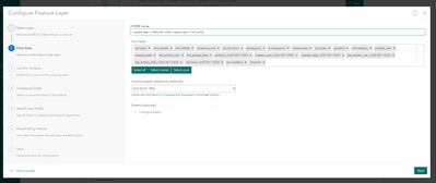

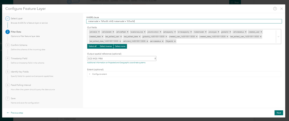

Pictured below, the where clause exception will not work if I use AND.
If I use just: makemodel = '%Ford%' it will work.  I read in the documentation that AND is recognized SQL-92 that Velocity will work with.
What gives?

SQL uses logical operators. The operator AND means "Both values have to be true". So in your query, you search for features where makemodel is both Ford and Toro. This is impossible, so the query layer will be empty.
You should use the logical OR, which means "At least one of these has to be true".
Also, not sure if this applies to querying feature services, but in "normal" SQL, % is a placeholder/wildcard for seaching text with the operator LIKE.
makemodel LIKE '%Ford%' will find features with "Ford Fiesta", "Ford GT", and "Ford Mustang". makemodel = '%Ford%' should only find rows with the actual field value %Ford%.

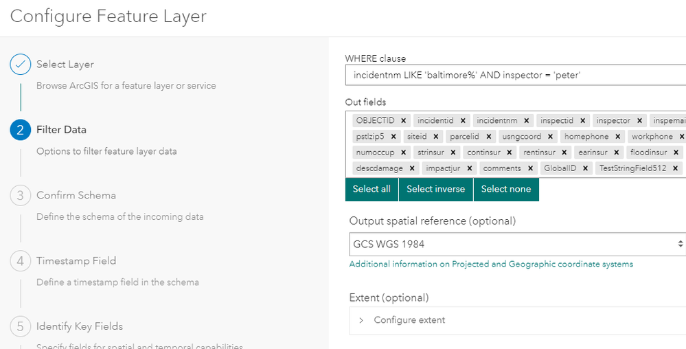

In testing on my end, I would also expect the % characters to work with the "LIKE" operator rather than "=" operator.
I confirmed success in testing with an expression such as incidentnm LIKE 'baltimore%' AND inspector = 'peter'
