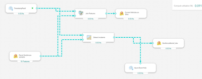

I have a workflow where I am using the 'Detect Incidents' Tool for Geofencing Vehicle locations at Pad Sites. Although this is working well for me with the ArcGIS Online context, I also need to publish this data to Azure Data Bricks for additional analytics. I am accomplishing this by outputting the Detect Incidents output to an Event Hub -> Data Lake while also pushing the data to a feature layer for visualization in parallel.

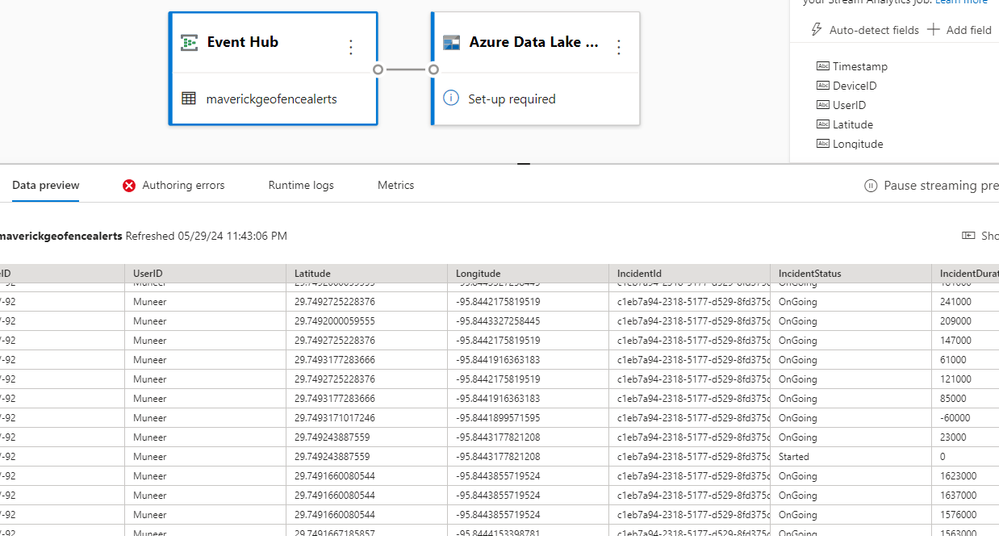

I am wondering if there is a way for the Detect Incident tool to only report the 'Started' and 'Completed' states ? I understand the tool runs in a stateful manner and needs to reference the latest observation for a change in state. However the amount of data we are curating with the Ongoing state is not desirable for our 'Time on Site' calculations.

Just add a Filter after the incidentDetect. Filter on INcidemtStatus not equal "OnGoing".   Or on "Started" and "Ended" in case they add a new Status later.

@JeffSilberberg This makes sense, and it seems this is the best way of addressing this issue. Cheers !
