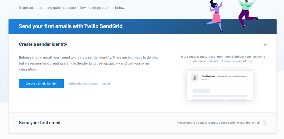

Once you have a SendGrid account, you will then want to create a single sender identity. A sender identity essentially is what represents you as your “from” email address. This is the email address that recipients will see as the sender and is what ArcGIS Velocity will use as the from email address. You can create a single sender identity from the SendGrid dashboard upon signing into your new SendGrid account. You will need to verify your single sender identity by checking the email you had specified. If you are using an email that is part of your organizations domain, you may want to consider reviewing any DMARC policies that are in place as this could interfere with using the email address as your single identity sender. In any case, follow the instructions provided by SendGrid to configure a single sender identity.
Create a sender identity after you sign into SendGridCreate a sender identity after you sign into SendGrid

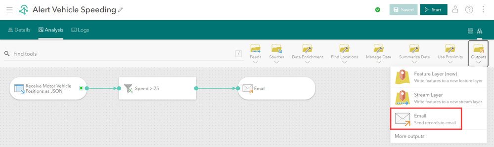

Now that you have established all the necessary SendGrid components, you can access ArcGIS Velocity and begin to configure an Email output that uses the SendGrid SMTP server. Navigate to an existing analytic, or create a new one, to begin configuring an email output. When you add an email output to an analytic, you will need to first open it to configure your SMTP settings.
Add an email output to an analytic from the outputs folderAdd an email output to an analytic from the outputs folder

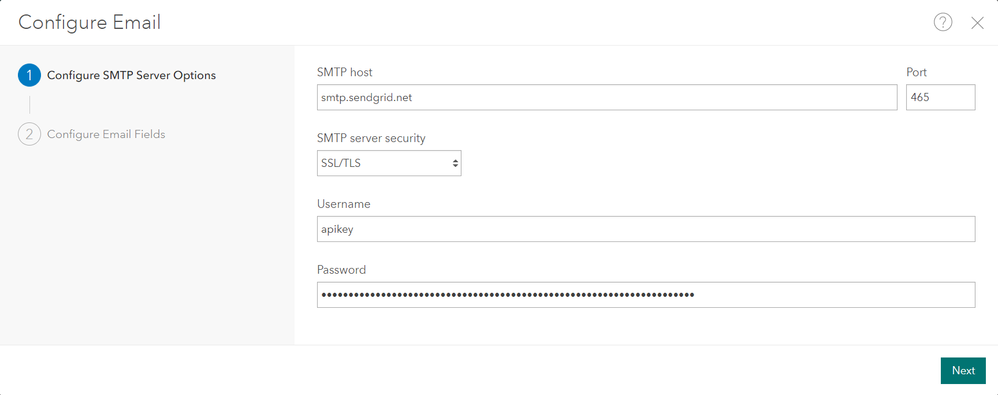

Step one when configuring an email output is to configure SMTP server options. If you refer to the SendGrid settings you stored from earlier, you will want to specify the SMTP Host property as the SendGrid SMTP Server (often smtp.sendgrid.net). By default, you can use port 465 and leave the SMTP server security property set to SSL/TLS. For the Username property, you will need to specify the username provided by SendGrid (often apikey). Lastly, for the Password property, provide your API key that was auto generated earlier.
Configure the SMTP Server with the SendGrid settingsConfigure the SMTP Server with the SendGrid settings

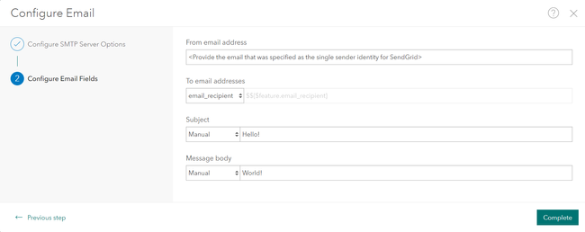

At this point, you should be ready to proceed to step 2 where you can configure your email fields. The From email address should be defined as the email you provided as your single sender identity. The remaining properties, To email addresses, Subject, and Message body can all be specified however you wish. You can either specify manual values, as I had done in the case of my Subject and Message body below, or you can reference fields and their values from your data as I had done using my “email_recipient” field for the To email address property below.
Configure email fields with manual entry or data valuesConfigure email fields with manual entry or data values
