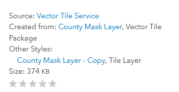

This is definitely possible, though the process may look different depending on your Portal version.
1. Go to your main Vector Tile Service; it will be the one that says it was created from a Vector Tile Package.

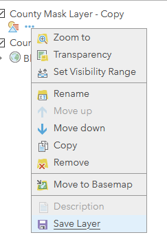

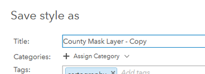

2. Open it in a web map. When you click "Change Style", you will be prompted to save a copy.
3. Save the copy, then adjust the style! Additional copies should be made from the "main" item as needed.

Hey Josh, thanks - it always helps to know that what I want to do is POSSIBLE.
And your step-by-step details with screen shots are awesome.
