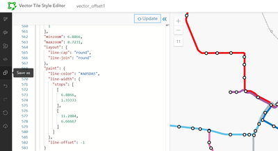

I'm editing a hosted (published) vector tile layer in VSTE. It has no Save option only Save As
How can I update the style (json) and apply it to the tile layer?

ArcGIS Online does not allow you to edit the styles on a hosted vector tile layer directly as it becomes the
‘source of truth’ when created from the vtpk file or feature service. You’ll need to make a new copy via the Save As dialog to save your changes. Once you’ve created a tile layer with your saved styles, you’ll be able to change that new layer as many times as you’d like.
