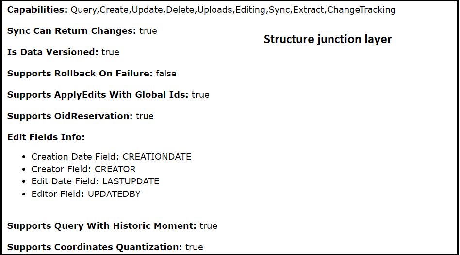

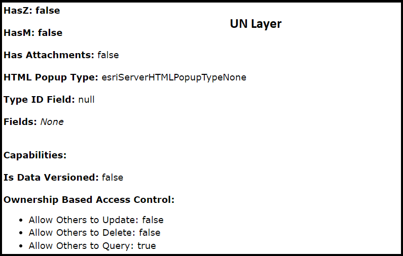

I am working with an ArcGIS Pro Utility network. I have published the Utility network dataset from my Enterprise database to ArcGIS Online. Prior to publishing, I have added global Id's, enabled editor tracing, and set my data as Branch Versioned, allowed updates and edits. I have noticed when I published data that all the layers within the dataset are versioned and allow updates except the utility network layer. Look at the image (one is structure device where versioning is enabled other is UN layer where it's not).

I am not sure what the cause of the error you encountered was, but don't think it was because the UN was not versioned.
What you are seeing for the feature layer properties .... I think it has to do with the UN layer itself being a group layer... If you look at the sub layers of the UN (Dirty Areas), you'll see that these are versioned.

MelissaJarman
