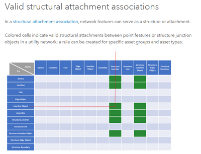

An example of this is - Connecting Electric Lines to Poles (Structure Junction)
Structural attachment is not possible between  the line and structure junction directly.
But looking at the matrix we can see that a structural attachment can be created for a Structure Junction and Electric Junction. and the electric junction can be placed on the line.
