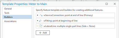

Actually trying to do the reverse- automating the creation of laterals where service meter locations exist (placing a tap on the nearest main, two-point line, meter at end of line). Basically, would want to select all of the meters with no laterals and have this rule fire. That was why I selected the junction (fitting) as my template. It may make more sense to select the meter as the template in this case, and then create laterals and taps, but I think doing it in this manner would digitize the lines in the opposite direction (won't matter since it's a UN, but still seems odd to have the fitting at the end of the line)
MikeMillerGIS
Esri Frequent Contributor
That is what I am saying.  You need to create the group template on the Meter.  That group template will End with the meter, but start with the Tap.
Here is an example.  My service connections are the meters
I create a group template on Service Connection and set the Tools to Line Tools
Then I add builders.  If I want the line to be digitized from Meter to Main, I ensure the Meter(Service connection in my example) is set to End of Line.  I then set the tap to Beginning of Line

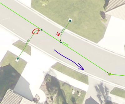

Would it be possible to create a version of this attribute rule specific for sewer laterals? In our system we show a dog leg at the end of laterals that points in the digitized direction of flow. I believe this is common practice in other sewer utilities and is often seen on the engineering/CAD files for projects. It maybe worth having it as an option in the initial setup of the attribute rule in the GP tool?
MikeMillerGIS
Might be tricky in the current framework, but I will log it and think about how to solve it.
