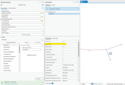

As two features of the same AG/AT are allowed to connected without a user junction, you are going to have to add the system junctions features and then preform a spatial join or some type of analysis to determine this.  The Utility Data Management Support toolbox has a tool to create a view of the system junctions.  Then you can use a spatial join to find count of intersecting lines per junction.
