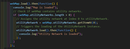

Acharya
Hi Leo,
Thank you so much for the help.
I am quite new in working with Javascript SDK.
Here, are some of the snippet of the code.
Loading the Utility Network.
Function to add Dirty Area Layer in the Code.
Initializing the UN Validate Topology Widget.
Best Regards
Shlesha
