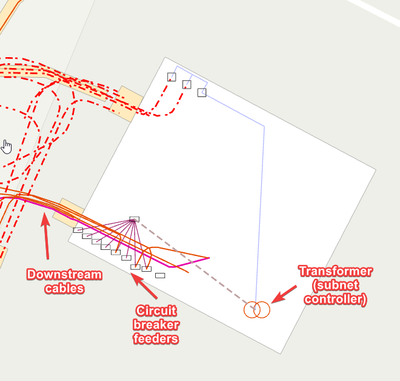

I want to automatically set an attribute, based on a trace, to every feature created in a utility network.
Example : I want every line created downstream a circuit breaker feeder, to have the name of this feeder affected in a specific attribute.  I have a subnetwork controller which is not my feeder but the transformer in the station. Then I want to trace upstream in the subnetwork, get the first feeder and get its name when I create a cable.

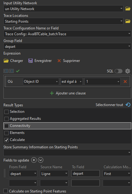

after a long time, I finally managed to test batch tracing.
So far, I created a modelBuilder that does the following steps :
- from a selected cable, I first run a "Build stating points" tool, to find the nearest upstream circuit breaker.
- I append the result to an existing feature class, similar to the StartingPoints feature class, where I added a "circuitBreaker" field.
- I calculate this field, with an arcade expression, returning the circuit breaker name from the UN feature class, to my new StartingPoints layer.
- Lastly, I run a "Batch trace" to update every cable downstream to the circuit breaker, and I want to update the field CBName ('depart' in french), with the circuit breaker name that I calculated previously.
This is where it doesn't work, I have this error when running the batch trace : "Casefold does not exist"
File "<string>", line 30, in <module>
File "D:\...\Toolboxes\20221017_Utility-Data-Management-Support-Tools-2.9\UtilityDataManagementSupport.atbx\udms\esri.py", line 111, in wrapper
File "D:\...\Toolboxes\20221017_Utility-Data-Management-Support-Tools-2.9\UtilityDataManagementSupport.atbx\udms\logic\__init__.py", line 126, in batch_trace
File "D:\...\Toolboxes\20221017_Utility-Data-Management-Support-Tools-2.9\UtilityDataManagementSupport.atbx\udms\logic\trace.py", line 193, in __init__
other_calledfuncs = other.calledfuncs
File "D:\...\Toolboxes\20221017_Utility-Data-Management-Support-Tools-2.9\UtilityDataManagementSupport.atbx\udms\logic\trace.py", line 193, in <listcomp>
AttributeError: ValueObject : obtention d’attribut : casefold n’existe pas
The trace I use is working when using the 'selection' option, it returns only cable features that have a CBName field. But not with the 'calculate' option...
Do you know how I can solve this ?

What version of the tools are you using?  The properties of the toolbox should have it in the description?  I reviewed the code and unsure why this is occurring.
PierreloupDucroix
MVP Regular Contributor
Version 2.9.0.2

Can you ensure you do not have an older version of the tool on your system.  Our only guess is that it is loading a module from an older version of the toolbox.  Your stack trace references a function that does not exist anymore.
PierreloupDucroix
I downloaded again the 2.9.1 version of the toolbox, and still have the same error :
This is the new stack trace :
File "D:\...\Toolboxes\20221021_UtilityDataManagementSupport_v291.atbx\udms\esri.py", line 118, in wrapper
File "D:\...\Toolboxes\20221021_UtilityDataManagementSupport_v291.atbx\udms\logic\__init__.py", line 158, in batch_trace
File "D:\...\Toolboxes\20221021_UtilityDataManagementSupport_v291.atbx\udms\logic\trace.py", line 195, in __init__
File "D:\...\Toolboxes\20221021_UtilityDataManagementSupport_v291.atbx\udms\logic\trace.py", line 195, in <listcomp>
Note that I removed other version of the toolbox, and even uninstall/reinstall ArcGIS Pro 2.9.5
I also tried in a new, blank project, to load my UN service, and run the batch trace... Same result
Thank you

Calculate is working for my test.  Are you using services, fgdb or mobilegdb?  Could you zip up the project so I can test?
