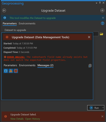

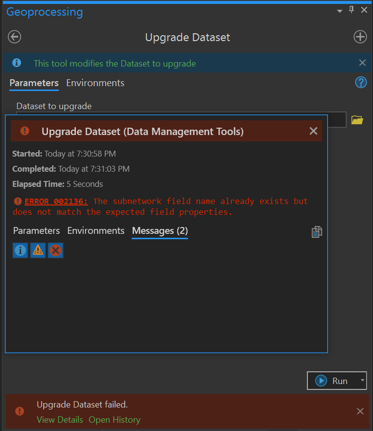

I am attempting to run Upgrade Dataset on an enterprise electric UN from v4 to v5. Services are turned off, locks and connections are cleared, network topology is disabled, geodatabase version is 10.8.1.2.6, database connection is using the UN owner.
Below is the error I'm receiving, which when going to the error link the solution (https://pro.arcgis.com/en/pro-app/2.8/tool-reference/tool-errors-and-warnings/001001-010000/tool-err...) mentions finding the specific field properties required for the SUBNETWORKNAME field in the Add Tier tool documentation. Is Upgrade Dataset trying to run Add Tier as part of its process? Has anyone else ran into this before?
