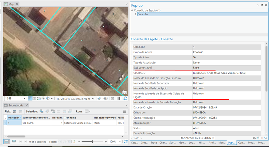

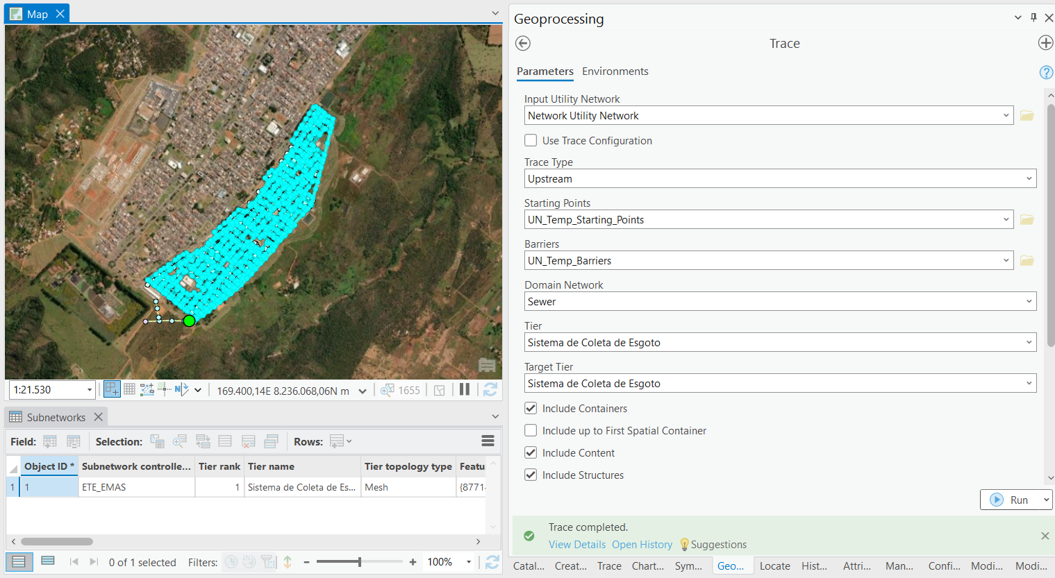

I'm working on a File Geodatabase (FGDB) and trying to run a trace to include all features in my sewer network results.
The subnetwork controller and the terminal were configured after applying the network.
Trace works fine for some features (Is connected and subnetwork name were updated when I created the subnetwork controller):
But is not working for junction and lateral line (ramal):

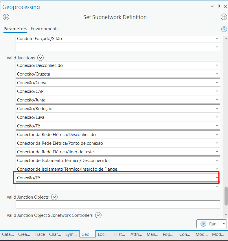

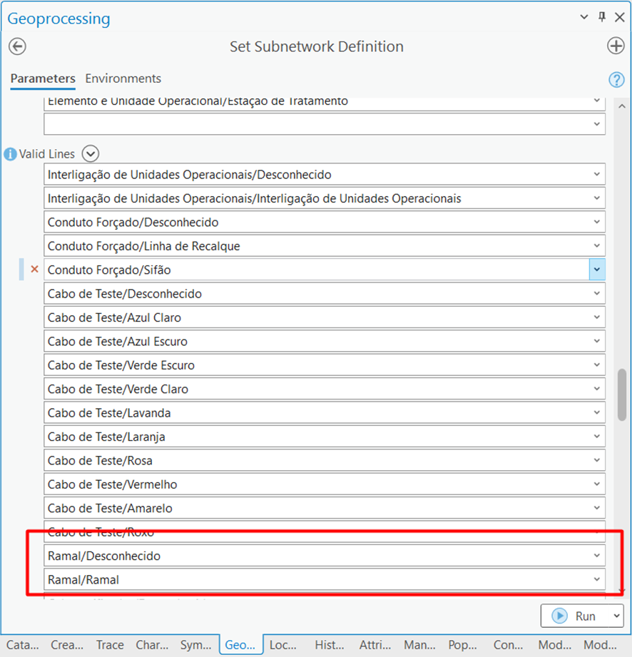

Features are configured as valid junction and line on set subnetwork definition:

check the attributes on the junction features that are used in the subnetwork definition, like lifecyclestatus.
