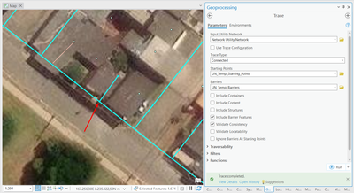

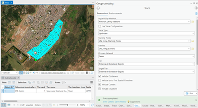

Trace works fine for some features (Is connected and subnetwork name were updated when I created the subnetwork controller):

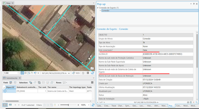

But is not working for junction and lateral line (ramal):

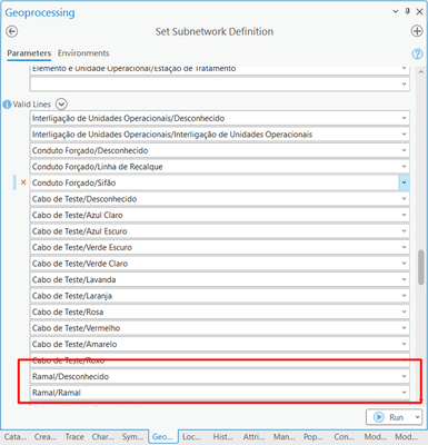

Features are configured as valid junction and line on set subnetwork definition:
Letciad_Agosto_Miguel_Fonseca_2-1733593404488.pngLetciad_Agosto_Miguel_Fonseca_3-1733593416340.png
