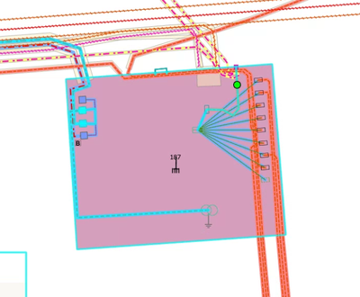

with the new tier group / tiers configuration, it now works as expected :
However, I had to modify my MV subnet definition to include some of the LV features (when applying the LV definition, I had an error saying that those features should be in the parent subnetwork definition).
Now the questions :
- is it normal in a hierarchical network that it is not allow tracing from a tier group to another tier group ?
- in any case, the MV subnetwork propagation stops at the subnetwork controllers. I have to manually put this in the condition barriers, is it expected in a hierarchical network ?
