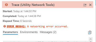

So, I'm trying to use the Subnetwork Trace tool (though the same thing happens with a Connected trace) and I consistently get the error "A networking error has occurred" (below).

EdwardBlair
Doh!   I had made a number of changes and neglected to re-enable network topology.    Re-enabling allowed me to trace.
In my (meager) defense, sometimes just by writing out a description of the problem helps lead to a solution.
Sorry!
