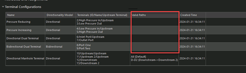

After reviewing your suggestions and reviewing the UN Network Properties I believe the tracing issue stems from missing expected "Valid Paths" in the Terminal Configurations (below). In the base stormwater solution, these values are set to "All [Default] None."
What is your recommended workflow for adding these missing values back to the terminal configurations?  I am working with Pro 2.9.8, UN Version 5. Thank you!

@Paul_Lalancette Curious, I didn't think you could create a terminal configuration without any valid paths, I'll put that on my list of things to try out tomorrow. You can't modify a terminal configuration once created, and you can't change an asset type's terminal configuration once it has had a configuration.
Unfortunately, this doesn't leave you with a lot of options, the easiest of which would be to export your utility network back to an asset package, put the appropriate configuration back into place in the asset package, and to re-deploy your utility network. It looks like you're still prototyping your utility network, so I hope this isn't too much of an inconvenience.
