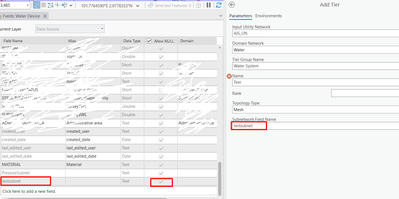

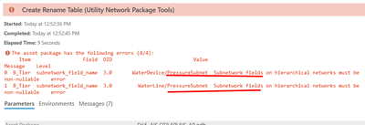

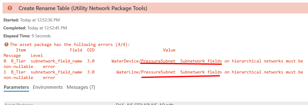

I have encountered error while trying to Create Rename Table in Asset Package with the following errors:

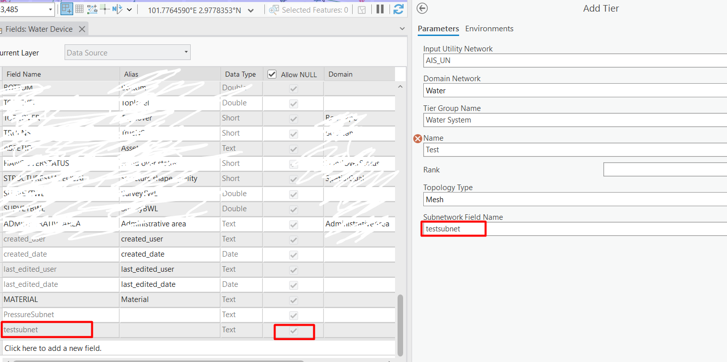

This error suggesting that Subnetwork Field Name which created by system when running Add Tier tool should be not nullable. But I did noticed that Add Tiers tools will create a Subnetwork Field Name that accept nulls value (I was just trying to add one more tier in the single-user Utility Network).
Was wondering why is it so? And how to ensure Subnetwork Field Name created is not nullable.

When you add a tier and there is data, it cannot add it as nullable.  In the asset package, just delete those fields from your classes.  The apply asset package will add these fields/tiers before data so they will be added correctly as nullable.
