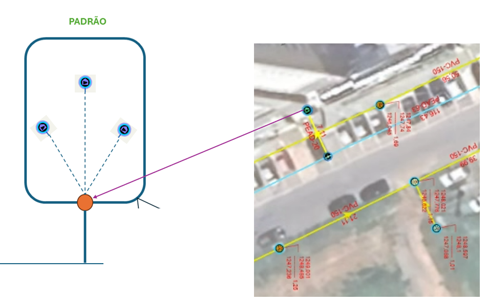

We are configuring a Water and Sewer Utility Network for a Brazilian customer with the following requirements:
  1. Representing multiple geographically represented service meters connected to a single service line (standard in this region).
  2. Selecting these service meters during a trace for further analysis.
Has anyone else modeled this scenario in a Utility Network? We would appreciate any best practices you can share.
Conceptually, the visual model includes a connection point or device (indicated by the orange point) at the service line termination, serving as the attachment for multiple geographically represented service meters.
Thanks for any input!
MikeMillerGIS
Esri Frequent Contributor
You can terminate the Service line with a service connection and then create an association to a meter or skip the service connection and add three more service lines from the end of a main service line to each meter.

We modeled a pretty similar scenario where we have a primary service meter connected to several secondary meters (the case of a building). We have two different asset types and each secondary meter is connected to the primary meter with a connectivity association. This way, you can use output parameters to select primary or secondary meters in your trace and subnetwork configuration.
