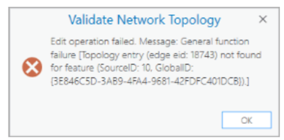

@MatteoMagnani_WT   I would add that the Rebuild Network Topology tool (and the rebuild current extent command on the Validate command dropdown are intended to specifically address inconsistencies in the network topology which prevent the topology from being properly validated and updated.  Here is an example:
As John mentioned, these can be targeted against a specific extent of your network exhibiting the issue.   Think of this as a targeted enable network topology operation that rebuilds the network in the extent regardless of the presence of dirty areas.
