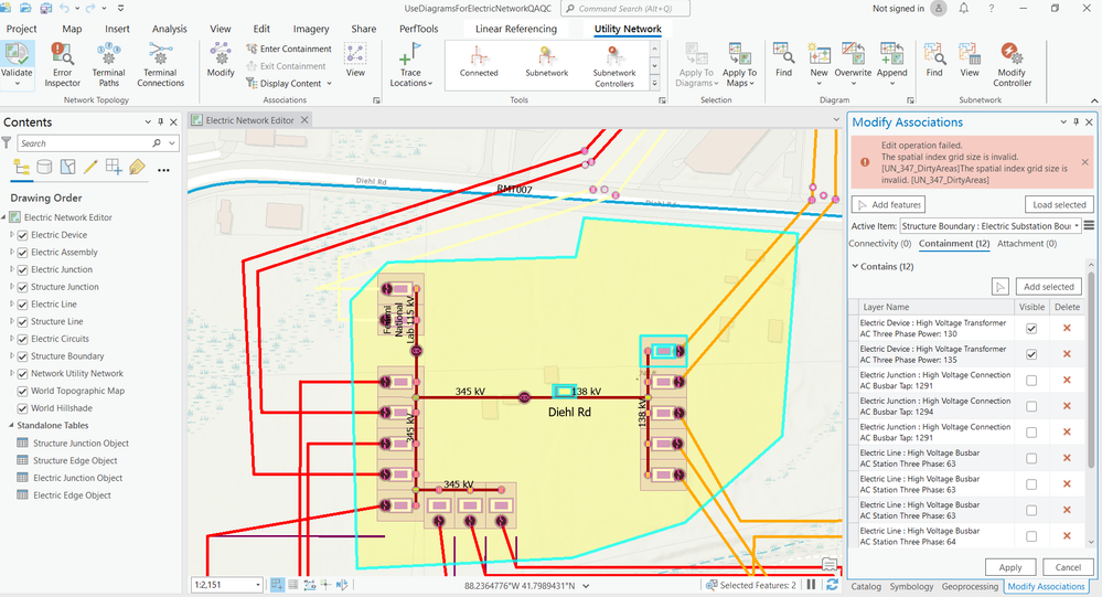

Can you please post a screenshot of the error? Once I see the specific tool/message I can give you a more precise response.
EvelynHsu
As shown below
RobertKrisher
Ah, use the delete spatial index and add spatial index tools to drop/recreate the spatial index on the Dirty Area layer in your map. Sometimes when a lesson is packaged the spatial index on the dirty areas layer can get reset to be too large or too small.
EvelynHsu
Thanks Robert. Removing/Adding spatial index to the Dirty Areas layer solved the issue.
