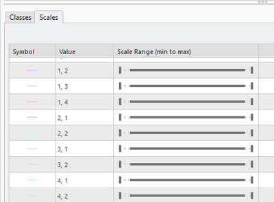

Symbology Scales - Use one layer in the map and use symbology scales to define the different scales.
This does come with it's challenges though - labels will need multiple classes set up, cannot toggle visibilty of certain features within the layer.
