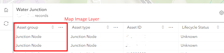

2. We have then published UNM by AssetType together with all the symbology, but it turns out that Asset group is displayed as code in Map Viewer. This happens to Feature layer (Utility Network). Anyone has any idea on what we should be checking at?
In Map Image Layer, asset group is able to displayed the description.

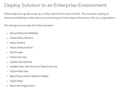

Ram
Hi,
Hope you have downloaded Water utility foundation solution. Expand 'Deploy solution to an Enterprise Environment' in the task pane. You will get step by step process in detail to publish UN service.
Use Water Distribution Utility Network Foundation—ArcGIS Solutions | Documentation
AmberY
Hello @Ram , thanks for highlighting this. I tried to follow the same, but I will get subtype field display as code in Map Viewer once I published by asset type which confused me. Do you have any idea on this? Appreciate any thoughts!
