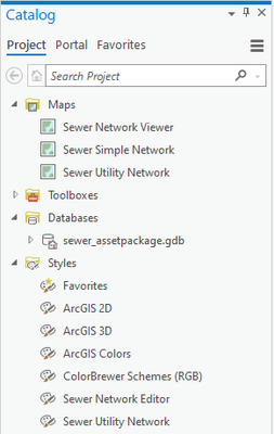

Can you try opening the Catalog pane and expanding the Maps, Databases, and Styles folder? The projects ship with everything closed. The Catalog pane can be opened from the View tab.

The project opens closed.
Of course.
Thank you, that resolved the problem.
