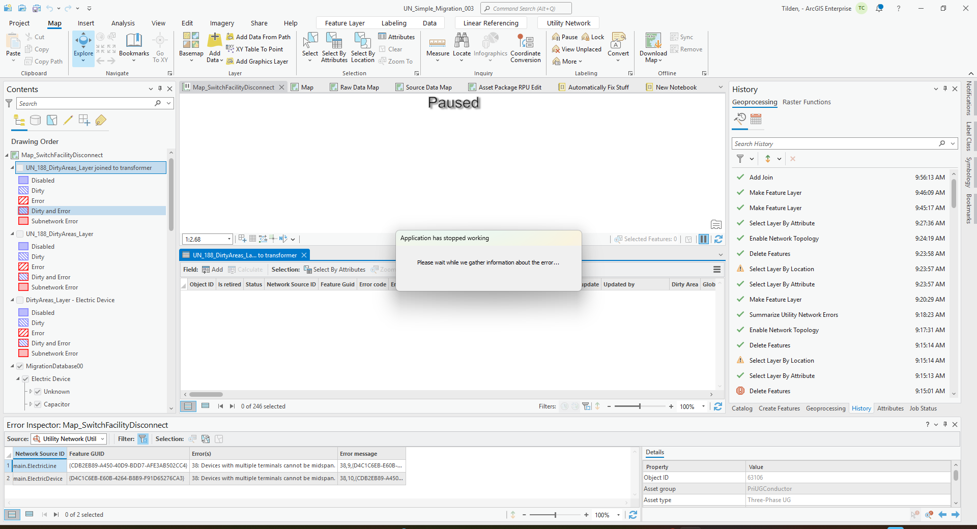

Hello Team,
We made a layer of Dirty Areas that looked at a specific Error Codes and limited to Electric Device (This ensured a smaller dataset on the new layer). Then we did an add join using Feature GUID. All went well. Then we went to open the Attribute Table and Pro crashed. We tried this on multiple computers and got the same result. Has anyone else seen this happen?
