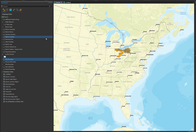

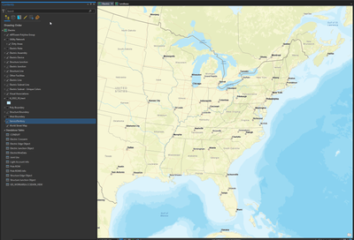

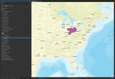

To assist with visualization of this and the concepts behind it I am going to share some shots from our implementation. By no means am I saying we got this right. Just showing what we did and how you might relate it to your work and work out the best path forward for your organization.
  1. Our UN defined SERVICE TERRITORY (the one Robert and John speak of above that cannot be changed)(second note - this area is the same for all three instances and all three instances are in the same projection.)
  2. We have three instances East, West, and South (I will show the footprint of the west instance.)
  3. Finally in the last shot are our migrated Poly Boundary layer which contains all the polygons from our old system. they are all in one layer but can be definition queried to get to what you need (Operating company, district, and so forth and then used for spatial analysis.)
