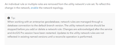

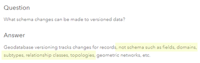

@Thom_Leeffers   Just to clarify, you should not need to unversion your data or "flatten your versioning tree" to make schema changes, add rules, etc.  While removing existing named versions to add rules, etc. may be completed as a best practice to prevent the need for additional steps to be performed with each existing version...it is not required.  The schema of the data itself is not versioned, and (as an example) any rules that are added to the Default version would be pulled into the named version through a reconcile.
Here's a KB in ref to versioning of table schema (older but remains relevant with branch):  https://support.esri.com/en/technical-article/000008159

Here is a doc reference regarding rule modifications wrt deletion:  https://pro.arcgis.com/en/pro-app/latest/help/data/utility-network/delete-a-connectivity-or-associat...
