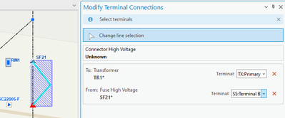

We are in the process of upgrading from system from Ent10.8.1, AGP2.7.4, UN3 to Ent 11.1, AGP3.2 (or greater) and UNM6.

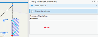

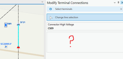

When reviewing or changing the terminals for a line, the modify terminals pane is blank.  This works as expected initially when setting a terminal for the first time, but outside of that workflow the pane is null.
As shown below, there are terminals set for this object, but modify terminals does not display the content.
Setting a new object showing the terminal config, that then is not visible to update

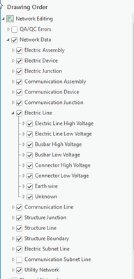

Is the UN Line layer repeated in the map twice?  What does your TOC look like?
DamienPyne
No duplicate references.  It is strange as it works for a brand new line then will not work for modifying data.
But i did add a brand new service in without any symbology, etc and this is working as expected.  Sounds like we have an issue in the map config.
Could a duplicate layer be the primary issue for causing this? (We shouldnt have any thus looking for ideas)
Edit: I added the data just raw not as subtype group layers as required for UNM content.  I went back and added the data again as subtype group layers and have the same issue.  This doesnt appear to be a duplicate layer issue.
