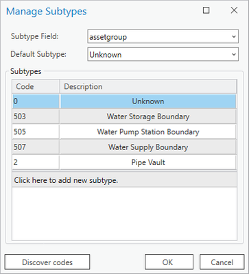

I just double-checked, and the data dictionary and the asset package match. Remember that asset groups are synonymous with subtypes. Here is a screenshot of the subtypes (aka asset groups) on the structure boundary class:

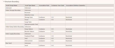

As you can see, they match the screenshot you provided of the data dictionary.

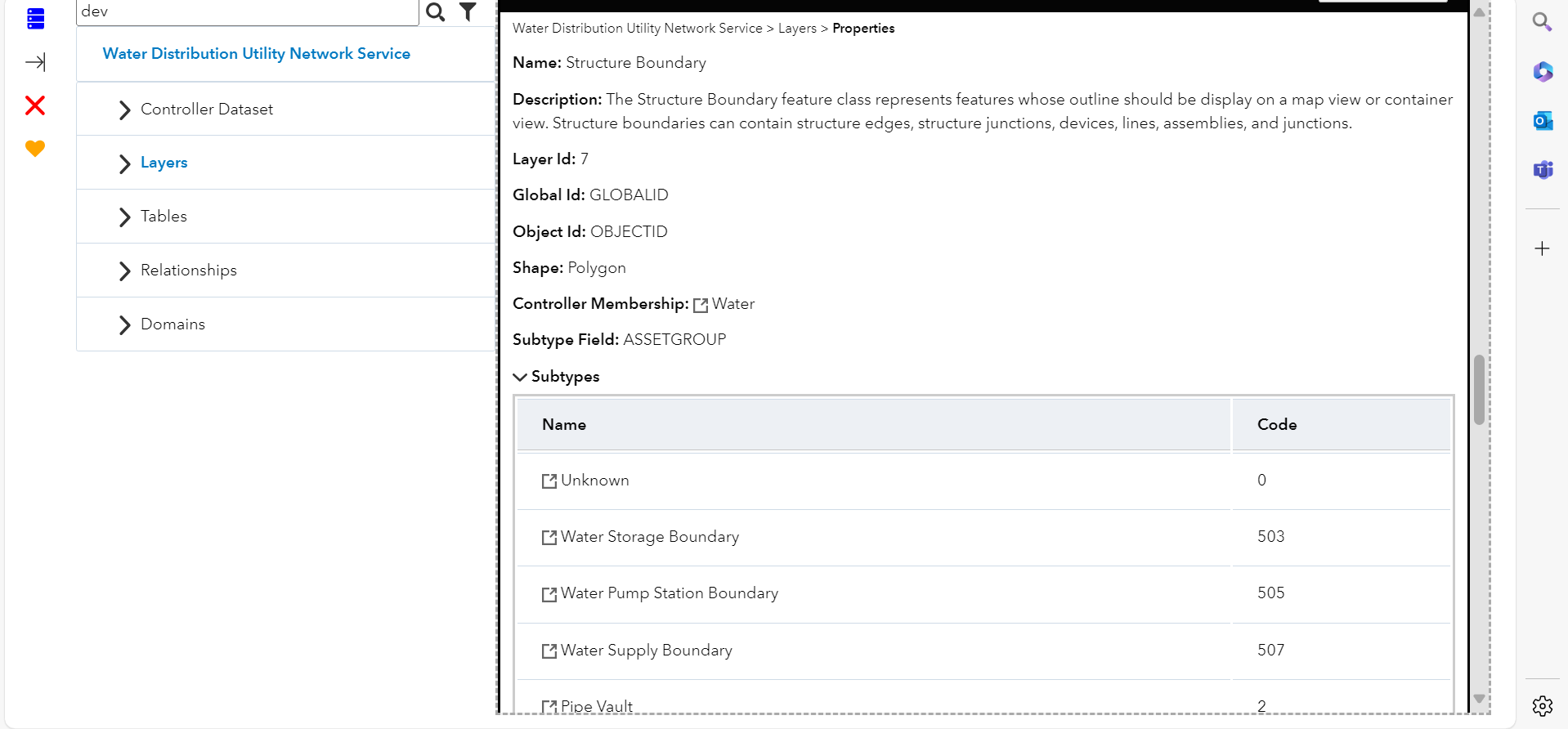

View from the UN properties:
