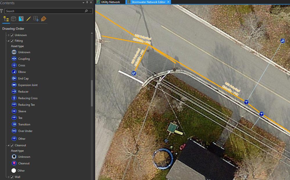

I have a unfinished Storm Utility Network sitting on my desktop in a geodatabase that includes fittings. I still have the package for that I believe, perhaps that would work for you.
