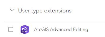

Hello,
I try to run a geoprocessing service that uses arcpy.un (to run a trace), but I get an error :
003049: The account logged into portal is not licensed with the Utility Network user type extension...
I am in enterprise 11.3.
To reproduce, I made a simple script that uses arcpy.un :
import os.path
from arcpy import un
arcpy.SignInToPortal("https://portalUrl/arcgis", 'adminAccount', 'pwd')
arcpy.AddMessage("connection successful")
arcpy.AddMessage(arcpy.GetPortalDescription(arcpy.GetActivePortalURL())["user"]["username"])
UN = r"https://portalUrl/ags/rest/services/Utility_Network/FeatureServer/0"
arcpy.un.VerifyNetworkTopology(
    in_utility_network=UN,
    out_log_file=r"in_memory\test"
the error https://pro.arcgis.com/en/pro-app/latest/tool-reference/tool-errors-and-warnings/001001-010000/tool-...
indicates that the user should have an Advanced Editing license, anyway I tried with an administrator account (with an ArcGIS Pro Standard license that include Adv Editing) or with a Creator + Advanced Editing...
Any idea ?

@PierreloupDucroix correct, a geoprocessing service runs within the context of the server and feature service. Does the account you're using to run the geoprocessing services have the correct user type extension? Is the script any better behaved if you use the ArcGIS API for Python instead of ArcPy?
ArcPy was originally developed for desktop analysis, so I have noticed that when you need to be precise with service login information in a non-ArcGIS Pro context that the ArcGIS API for Python (which was developed to target AGOL/ArcGIS Enterprise) is more reliable.

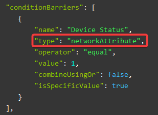

I think the trace is not honoring my condition barriers.
Previously it was condition_barriers="'E:Etat coupure' IS_EQUAL_TO SPECIFIC_VALUE 1 OR",
and now I translated into
    "condition_barriers": [
            "name": "E:Etat coupure",
            "operator": "equal",
            "value": "1",
            "combineUsingOr": True,
            "isSpecificValue": True
But no matter how I format the condition_barriers, I get an error that "more than one subnet controller are discovered", whick I can reproduce in ArcPro by deleting the condition barrier.
Do you know if there is a parameter that could bypass my condition barrier ?

@PierreloupDucroix You will need to include your condition barriers as part of your trace configuration object and because the trace configuration object in ArcGIS API for Python is a 1:1 match for the rest spec object you need to make sure your key names match the rest spec: conditionBarriers, incluseContainers, etc

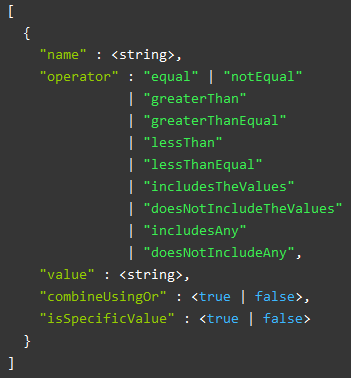

Thank you so much, Robert,
I mixed naming from arcpy and Rest.
--> AND there is an omission in the documentation :
in the REST trace doc (https://developers.arcgis.com/rest/services-reference/enterprise/trace-utility-network-server/#trace...) the conditionBarriers is described like this without the "type" field resulting in an error "missing required field in JSON" :
but fortunately, in the example this mandatory field is present

CEO of MAGIS
RobertKrisher
@PierreloupDucroix the two classes are the same instance of the same class. The underscore indicates that it is an internal variable that you shouldn't be using. The API does have a certain amount of flexibility with handling different URLs.
I have made note of the issue with the documentation and forwarded it to the team responsible for maintaining the online help.
