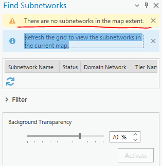

Hello Community,

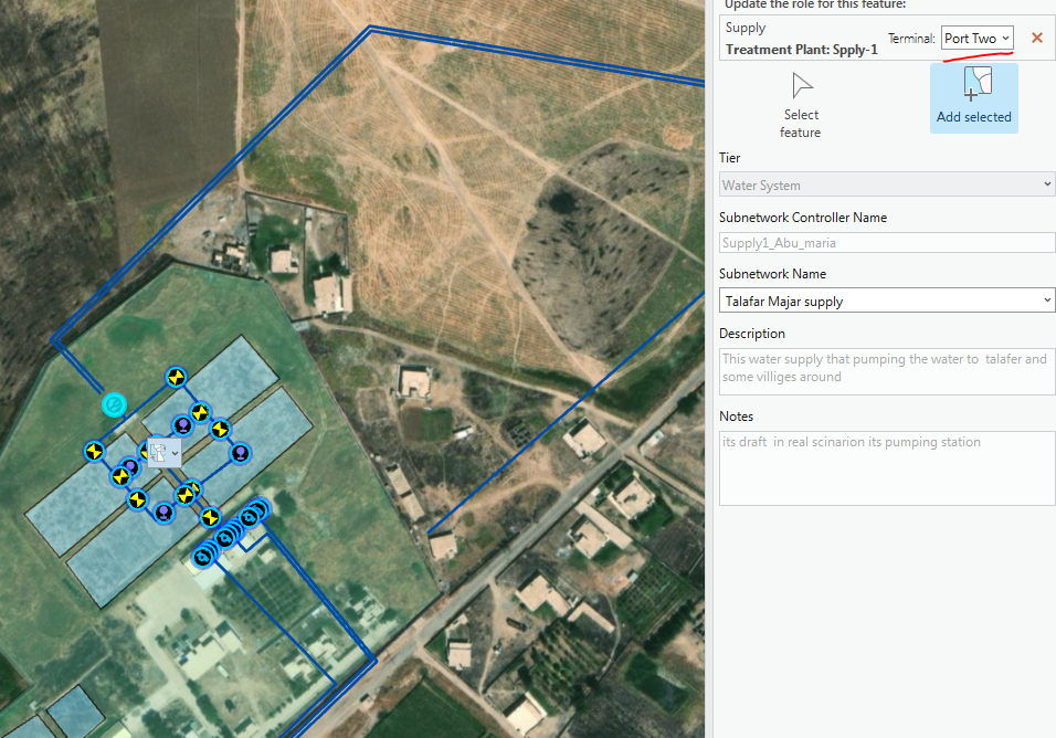

I've recently completed the topology cleaning for my utility network case and subsequently created a few subnetworks, specifically for water supply and pressure. However, I'm encountering an issue:
the network doesn't display in find network show message "There are no subnetworks in the map extent." which is a step to update the subnetwork.
I'm unsure if I've missed a step or if there's another underlying issue. Any guidance or advice would be greatly appreciated.
Thank you in advance for your help!
RobertKrisher
@FaisalAl-Yaseein the find subnetworks pane filters that list using the subnetwork lines in your map. Because you don't have a subnetwork line for this subnetwork, yet you need to go to the filter category of the find subnetworks pane and filter on the subnetworks table. This will show you the complete list of all subnetworks.
