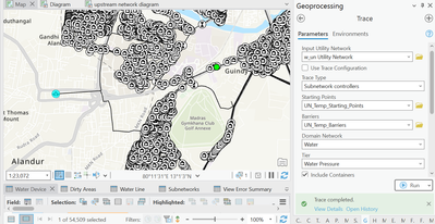

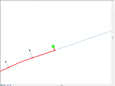

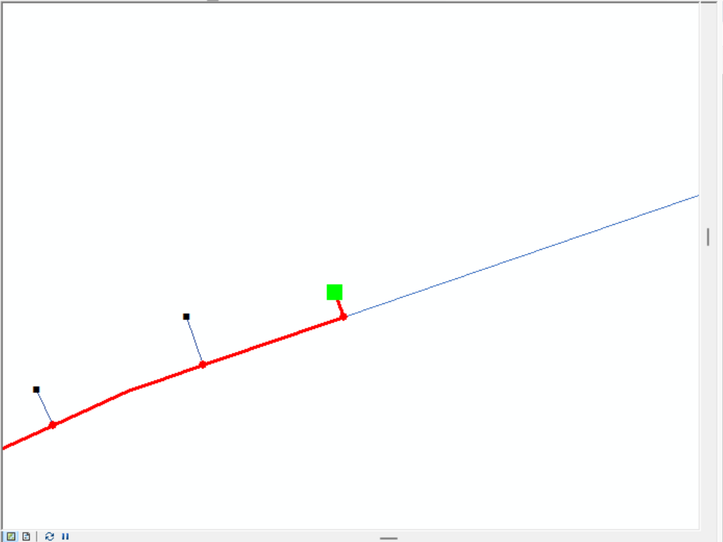

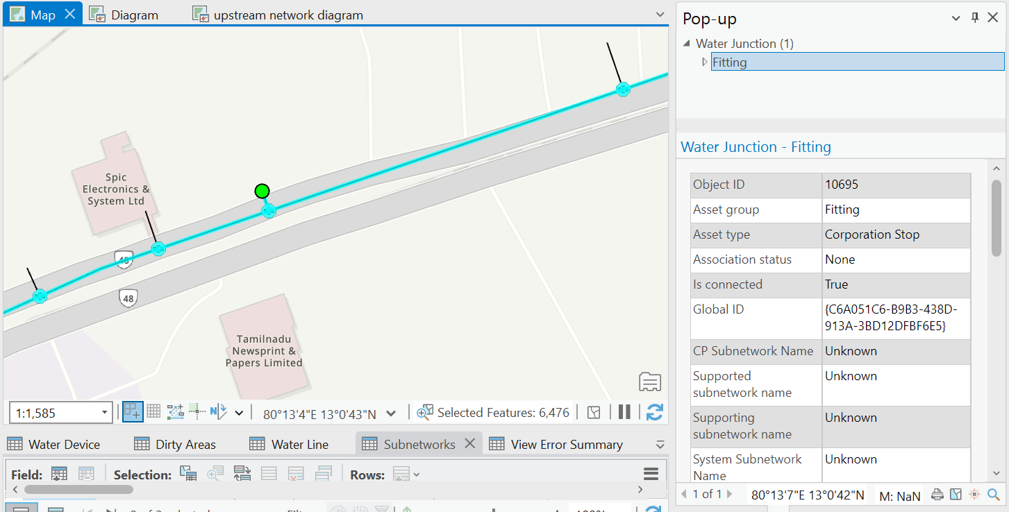

I have a water utility network, where when i tried to perform trace, the water flows in in two ways, which got me wondering having a corporation stop as a fitting wont water be stopped? because i just wanted to know what all the possible ways the Geometric trace and Utility trace differs, so I am attaching both the screenshots.

It depends on your path to the controller.  If is a mesh, like a pressurize system, both directions have a path to the controller and you have indeterminate flow.  Flow direction defined by the edge is not available until 3.3.  Run a controller trace, does that provide a single path or both?

Now run a path trace, between the controller and your point.  Put a barrier on the line to the left of your trace location, does it show a path the other direction?
Angiex__1
Its rerouting and going through the other possible way.
MikeMillerGIS
Esri Frequent Contributor
Then the trace results are correct, there is a path from directions to that location.
