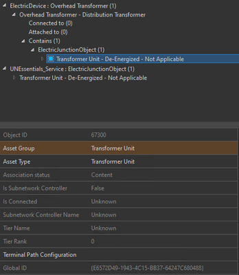

RobertKrisher
It looks like a bunch of your features have no terminalconfiguration (like in the last screenshot). Set their terminal configuration to be default, validate, and see if that fixes the issue.
That value should be defaulted on every feature in the network, and when it is null or invalid it causes many other errors in the model to appear. Make sure that however data is/was being loaded that you initialize that field with the default value.

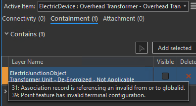

Thanks for responding, yes I have some screenshots, all for the same feature, a distribution transformer that's supposed to contain a transformer unit (EJO):
Here's the error in the data inspector:

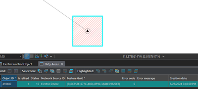

And the map.  Note that the dirty areas table does not display a code or message.

This is only containment, so I'm not sure why terminals are adding to the error.  I checked the csv and the terminal fields are null, shown above.  Please let me know if you'd like to see more.
RobertKrisher

Are you referring to the Terminal Path Configuration attribute?  If so.. you might be onto something. I did not validate the features after appending but before importing associations, which might be why this attribute didn't aut-set itself.  That, or I will need to modify the appended tables to set that beforehand.  I will try this and report back.  Thank you very much!

The Terminal Path Configuration attribute needs to be populated when you append the data. If it is not populated when you validate it will not auto populate, it will instead create an error.
VanCityUtility
Sorry, you're correct it doesn't auto-populate - I was only looking at the ED features which do have it.  I reviewed the schema coming from the staging gdb and found that this attribute was blank for the EJO records.  I simply bulk edited the service features and validated with success, and a full workflow test was also successful with that fix.  Thank you so much for your help!
