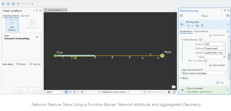

AyanPalit
@SillPaul A conceptual solution will be to use a Trace configuration and use an Add function which will sum the targeted Network Attribute (Shape_Length) as it traces the line features.
AyanPalit_1-1741039809423.pngReview the documentation and the following blog:
Exploring the ArcGIS Utility Network Trace Framework
