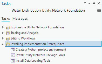

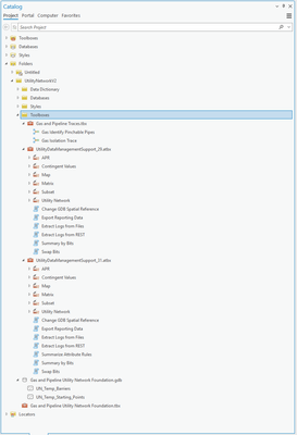

How do I stage the UPDM to our SQL enterprise database? I don't see in the toolboxes that are in the utility network folder I downloaded from the Solutions page. Thanks
RobertKrisher
you need to clone your conda environment and deploy the untools. This will give you access to the utility network package tools that are used to stage/deploy a utility network. You should have done this as part of the installing implementation prerequisites task.
