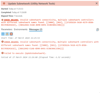

facing an issue with creating Multiple subnetwork controllers.

I am trying to create a new subnetwork controller and I have come across this error and how to solve this.
RobertKrisher
Hierarchical networks only allow features to belong to more than one subnetwork as long as those networks belong to different tiers. You can belong to a pressure zone and a system, but not to two different pressure zones. If 5000 were a pressure zone and DGS was a pressure system, you wouldn't receive an error. Because both of these subnetworks are the same tier they are not allowed to be interconnected like this.

Hello, I think the error is explicit : you have two controllers with different subnetwork name that are connected.
Here you can find how to solve this error : https://www.esri.com/arcgis-blog/products/utility-network/water/water-subnetwork-errors/

@PierreloupDucroix Since its a hierarchical type of network , why cant i be able to have two subnetworks in them? or i dont know where i am explicitly going wrong.
RobertKrisher
MichaelParma
Another thing I like to do is go back and check my subnetwork controllers were set on the correct port. It's rather easy to accidentally set a controller on Port 1 when you meant to set it on Port 2. I've inadvertently created multiple controller conflicts several times this way.
