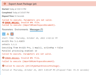

I was trying to export asset package from a UN file geodatabase. I am using untools 3.1 and Arcgis pro 3.1.
Utility network version is v5 and the file geodatabase was originally on arcgis pro 2.9.6 release. Does it have any dependency. Any pointers would be appreciated..!

Bala, in the output folder, there should be a temp folder with the xml.  We need to take a look at it and see what is wrong.  Something like this.

Troubleshooting the failure of import xml is very complicated.  We would need to look at them to see if anything stands out.  Can you email them to us ([email protected])?  They do not contain data, just schema.

Thank you for the file, we found the export was stripping whitespace from a domain coded value.  The result happened to match another domain code, which resulted in an invalid xml file.  The quick fix is to remove these codes that have whitespace at the beginning/end.  Review the warning messages, it will report what codes were adjusted.
