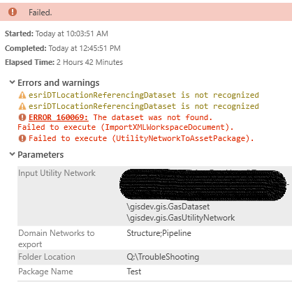

We are attempting to export our Utility Network from an enterprise geodatabase to a filegeodatabase, and the "Export Asset Package" keeps failing with the following error:

There were some changes made in untools 2.6.1 for import/export of LRS. That particular warning should only present in < 2.6.0

Thanks for the quick response- we are trying that now.
