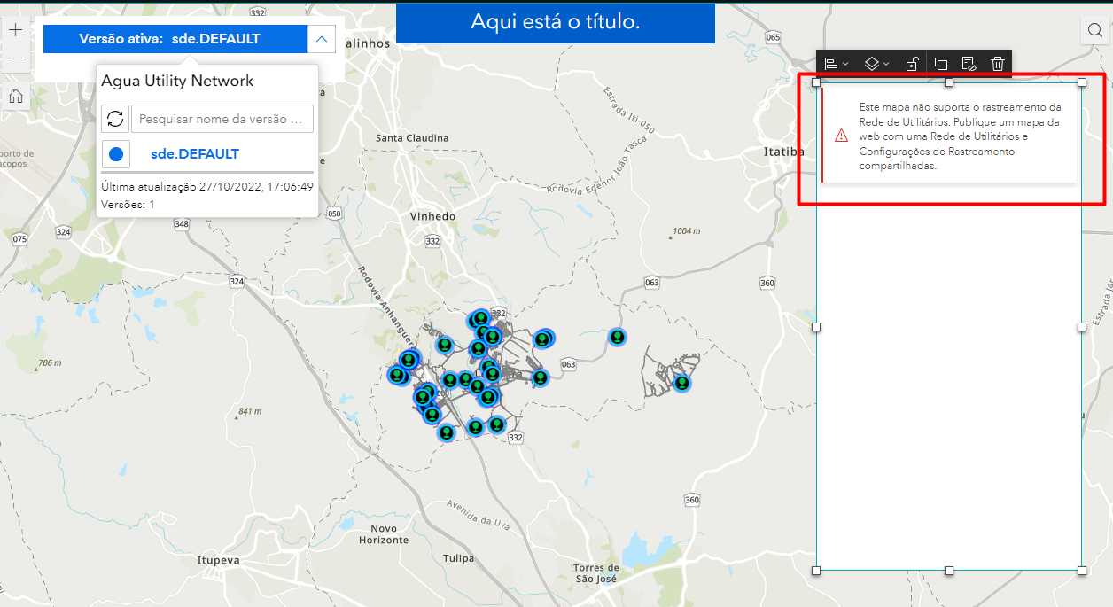

I'm tryng to use the widget Utility Network Trace (BETA) in the Experience Builder Dev 1.9, and I saw this error.
Translate the error:
"This map does not support Utility Network tracing. Publish a web map with a shared utility network and Tracing Settings."
I followed the tasks in the Water Utility Network Foundation, to create de UN, and publish. I did the configuration about the tool Add Trace Configuration too, and was not a sufficient. How would I solve this problem to use a widget in the ExB.

Hi @MatheusSparapani , please see the steps to Create a utility network and a web map for tracing and see if this works for you. You need to make sure to publish the web map using ArcGIS Pro including the feature service and the shared trace configurations.
MatheusSparapani
Hi Alix, how are you? Thank you for the aswered post.
I'had obtain this error, following the steps in the Create a utility network and a web map for tracing, I tested all possibilities that a saw in this blog, but, I'm not have a succesfully to use this widget.
