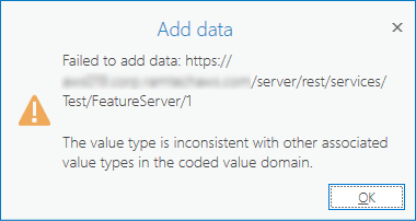

I've published a Utility Network to portal but when I try to add the UN or any of its layers to a new map, I get this error...
"The value type is inconsistent with other associated value types in the coded value domain."
I got this when loading some data into one of our testing systems.  I was never able to figure it out but when I build a new test system, I didn't seem to be getting it there.  Well, now it's showing up on this new system and data that worked before is not working anymore.  I couldn't find any logs or anything that would give any additional details about what value type or coded domain is the issue.  Is there any way to know what ArcPro doesn't like with the data that can be fixed?

I thought I had something for a moment.  First, I checked the logs after changing the logging level.  There was a lot of stuff in there but nothing that seemed to suggest any problems that I could find.  I then tried loading the schema only and got the same error.  So as you suggested, seemed like it was not a data issue.  I then tried loading an older version of the data and it did publish successfully.  There was some minor changes to the UN properties so this sounded like it might explain the issue.  But I wasn't able to find these changes.  Not sure where they went.  And now I seem to be where I thought I was before where any version of the asset package, even ones that worked before give this error.  So this makes it seem like something broke in the system and nothing will work now.  Tomorrow, I might have to try another system to see if I can get anything to publish there.  But this is what I thought I remember from last time.  Once I started getting this error, I would always get it even with data that worked before.  So without any detail about what causes this error, I have very little to go off of to look into what to change to avoid it.

Well, I keep going back and forth on this one.  I saw there was an update for Pro to 2.6.3.  I installed this update on a system that was getting this error and I was able to publish and access my data again.  For a time.  But the error came back.  Another system I built to get around this issue was working fine for a bit but now is also getting this error.  I found that I was able to restore an existing SQL backup and publish that without error.  But starting with an empty database and applying the same asset package that was in the SQL backup will give the error.  So again, without any specific details from Pro about what values specifically it has a problem with, I have no way to track down if it's a data issue or possibly a processing issue.  This most recent tests suggests that it might be a data issue.  But possibly the data that is being generated by the loading of the asset package or some other process involved before publishing the layers.

I had a similar error when was trying to create a map from the Gas and Pipeline Data Management for ArcGIS Enterprise Feature Service (with Location Referencing enabled). In the initial map I added layers from the ArcGIS Utility Network  and ArcGIS Pipeline Referencing (Gas PDM v1.1), then applied symbology for Gas Utility Network layers (i.e. exported Layer from the Gas Utility Network map and then imported Symbology in the respective layers of new map). Finally, I published a new Feature Service to the Portal (ArcGIS Enterprise 10.8.1, Pro 2.6.2). I got the exact same error "The value type is inconsistent with other associated value types..." when was trying to add the above feature service to a new map.
Researching the issue, I found this post. Based on a tip from Paul, I have re-created the map and published the feature service with the default symbology (as created by adding layers from the Catalog database connection to the Map). Publishing with the default symbology resolved the error, I can now add the feature service to a new map. Thanks for the tip.

I can published with the default symbology but the error continues, I can't add the feature service to a new map yet. By the way i can access data on the mapviewer without any errors.
