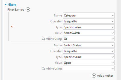

Right - So I got some success.
I used Filter Barriers instead of Condition Barriers (Traversibility)
Right, so I realized I was getting the concept of Traversibility Barriers and Filter Barriers mixed up.
The way I have understood this is Traversibility Barriers are where the Network Trace can travel where as The Filter Barriers are where the trace should stop.

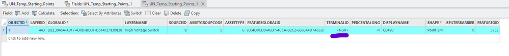

Another realization has been that - if you are using the GUI to create starting points the terminals matter. I found I had to trace both terminals to actually get the trace to leave the device.
If you scripting then best to create a start point feature class without TerminalID set.

If anyone needs more clarification this can be found here - https://pro.arcgis.com/en/pro-app/latest/help/data/utility-network/barriers.htm
Filters
Filters are evaluated and applied on the second pass of a trace operation to allow the discovery of subnetwork controllers so that flow direction can be established. There are two types of filters: filter barriers and filter function barriers.

Are you looking for the first downstream device that is a smart switch OR open? or that is an open AND a smart switch?
When I ran a trace on a device with terminals and left its terminal ID blank, I got an error.
In terms of how filter barriers are applied, they have a special behavior when dealing with devices with terminals. They are only evaluated when we cross an internal edge of the device. This is why if you start at the downstream edge of a protective device we will stop on the device, but if you start on the upstream edge, we return the upstream protective device. Its this same behavior that keeps us from treating distribution transformers as potential barriers (unless you cross from LV to MV).
