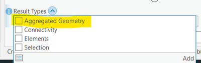

jclarke
If you are using Pro, you could take a look at the "Aggregated Geometry" result type - this will create new map layers for the results, so you can display just those layers.
DasheEbra
Thanks dear, it's a good solution. But the new layers appeared with no subtype groups Is there a way to display theme with subtype groups (Asset group) same as the original layers?
