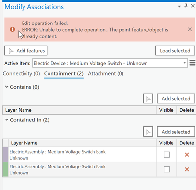

I am confused about an error I am seeing when trying to create a containment association between a Device Feature and multiple Assembly features.
"Error: Unable to complete operation., The point feature/object is already content."
Workflow:
-  Electric Utility Network Foundation template version 3.4 published to V 10.8.1 Portal.
-  A user attempts to Contain a Electric Device : Medium Voltage Switch inside of three Electric Assembly : Medium Voltage Switch Banks

I can replicate one-to-many behaviour for lines - e.g. containing a duct within multiple trenches. I cannot however do this for point network features, such as containing a device in multiple assemblies (of the same type or otherwise).
Is there a restriction not documented about where one-to-many containment is valid/invalid?
JonDeRose
@JonathanDaweEsriUK Nested containment is supported ( i.e. For example, a substation can contain a junction box, and the junction box contains electrical devices...) ; however, we do not allow for a point feature/junction object to be contained by more than one container.
