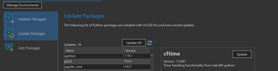

The Update Packages list only shows untools 2.6.0, even after refreshing. It is the same version of the untools that is already installed in my environment. Nevertheless, I hit the "Update All" button, but the result was the same. Which version of untools are we looking for?
JürgenBiendara
Hi Paul
So it is untools 2.6.2 we are looking for. Any idea how I can install it? As mentioned below, my ArcGIS Pro doesn't offer it for installation.
