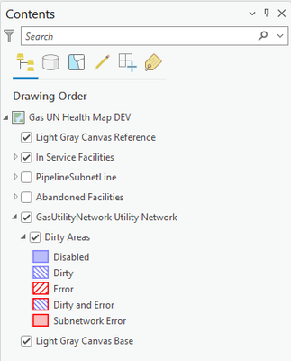

Enterprise 11.3 and UN 7.  I have a UN-capable feature service that includes dirty areas as a layer. I added the service to a map in Pro 3.3 and shared as web map to portal. In the Map Viewer in portal, the dirty areas layer is missing. The other layers come from the same service and come in correctly.
Pro:

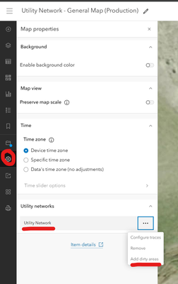

@JakeJacobsAVA  - Hi, I think this is by design. The UN layer and Dirty Areas don't appear along with other layers by default.
Go into settings -> Utility Networks -> Select the one you are interested in and add the dirty areas.
This then adds the dirty area layer to the list of layers.

gis_KIWI4
JakeJacobsAVA
Thanks! I had no idea that there was a separate setting for it. I did find it in the help for those who might like to bookmark, after I knew what to look for: Work with utility networks (Map Viewer)—Portal for ArcGIS | Documentation for ArcGIS Enterprise
